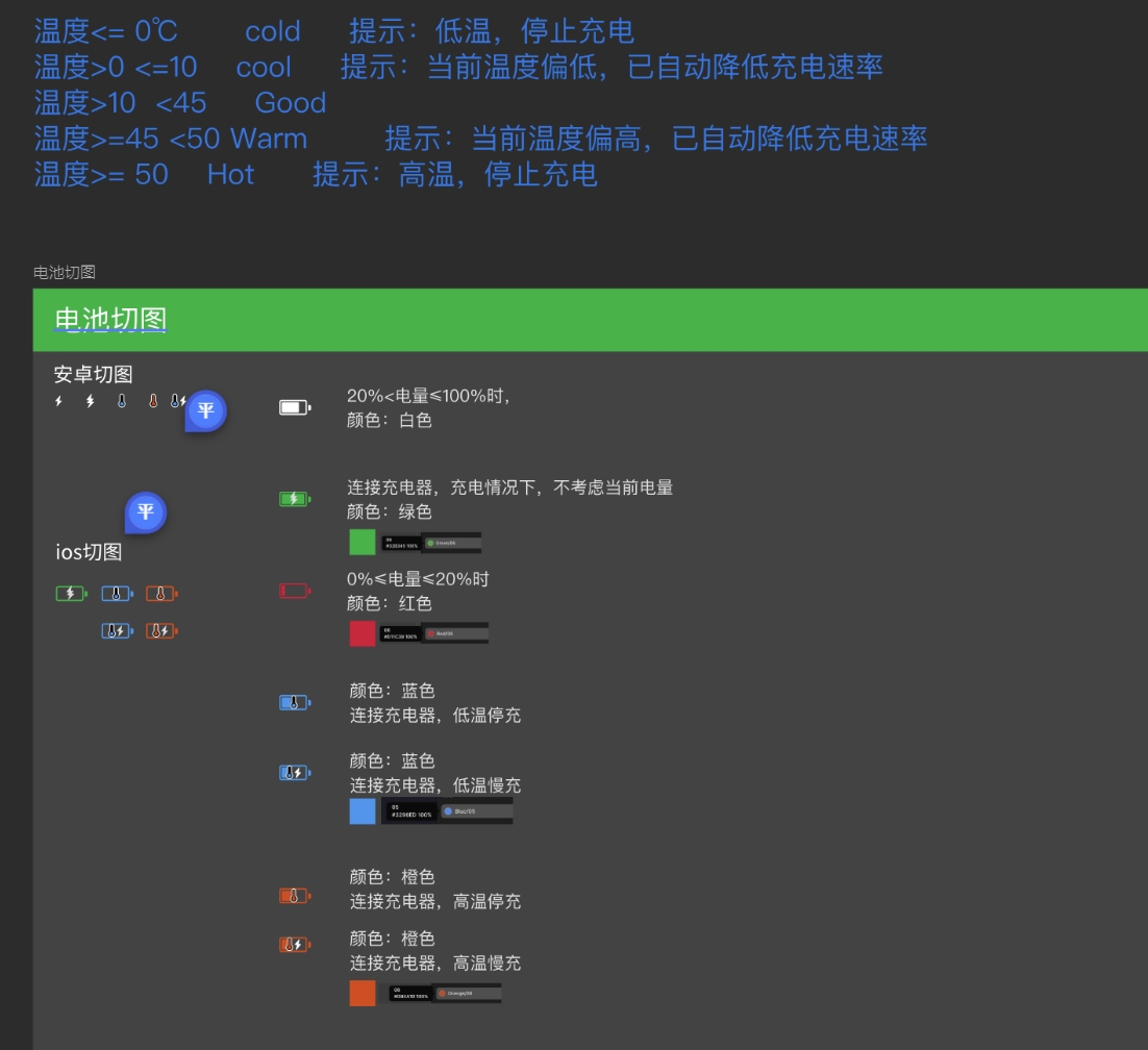

Q1: Seestar APP中电量图标的含义是什么? | Q1: What does the battery icon in the Seestar APP mean?
A: Seestar APP中的电池图标颜色用于表示当前电量状态和充电情况,具体含义如下:
A: The color of the battery icon in the Seestar APP is used to indicate the current battery level status and charging status, with the specific meanings as follows:
- 白色:未在充电,电量在25% < 电量 ≤ 100%
- White: Not charging, battery level between 25% < battery level ≤ 100%
- 红色:未在充电,电量在0% < 电量 ≤ 25%
- Red: Not charging, battery level is 0% < battery level ≤ 25%
- 绿色:正在充电,处于正常充电状态
- Green: Charging, in normal charging state
- 蓝色(电池框内有温度计,无闪电):已连接充电器,但因低温(<0℃)触发停充保护
- Blue (thermometer inside battery frame, no lightning bolt): Charger connected, but charging stopped due to low temperature (<0°C) triggering protection
- 蓝色(电池框内有温度计,有闪电):已连接充电器,因低温(0℃<温度≤10℃)处于慢速充电状态
- Blue (with thermometer and lightning inside the battery frame): Charger connected, in slow charging state due to low temperature (0°C < temperature ≤ 10°C)
- 橙色(电池框内有温度计,无闪电):已连接充电器,但因高温触发停充保护
- Orange (thermometer inside battery frame, no lightning bolt): Charger connected, but charging stopped due to overheating triggering protection
- 橙色(电池框内有温度计,有闪电):已连接充电器,因高温处于慢速充电状态
- Orange (thermometer and lightning symbol inside battery frame): Charger connected, in slow charging state due to high temperature

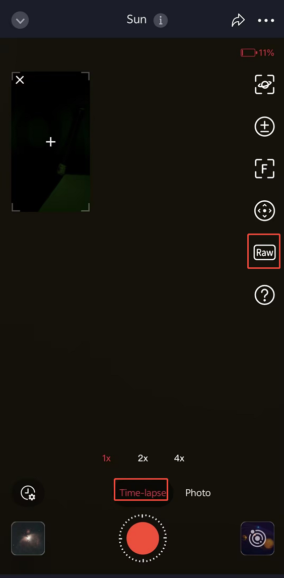

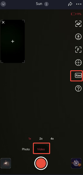

Q7:太阳系模式如何选择Raw格式?
Q7: How do I capture footage in RAW format under Solar System Mode?
Enter Solar System Mode and select your intended celestial target. Navigate to either Time-lapse or Video mode at the bottom menu bar, then tap the RAW toggle button on the right-hand panel. You may then start recording RAW video.

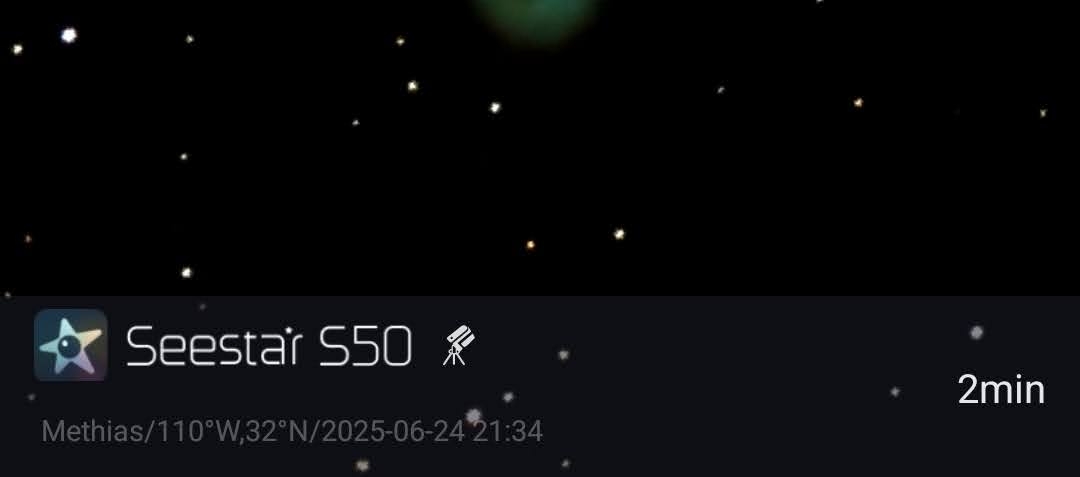

Q1: 为什么拍摄目标为 Unknown 时,开启水印只显示坐标和位置信息,不显示目标名称和头像? | Q1: Why does the watermark only show coordinates and location when the target is Unknown?
A:因为该目标在数据库中未匹配到,APP 无法获取目标名称和头像,所以只显示坐标和位置信息。
A: Because the target was not matched in the database, the APP cannot retrieve the target name and avatar, so only the coordinates and location info are shown.

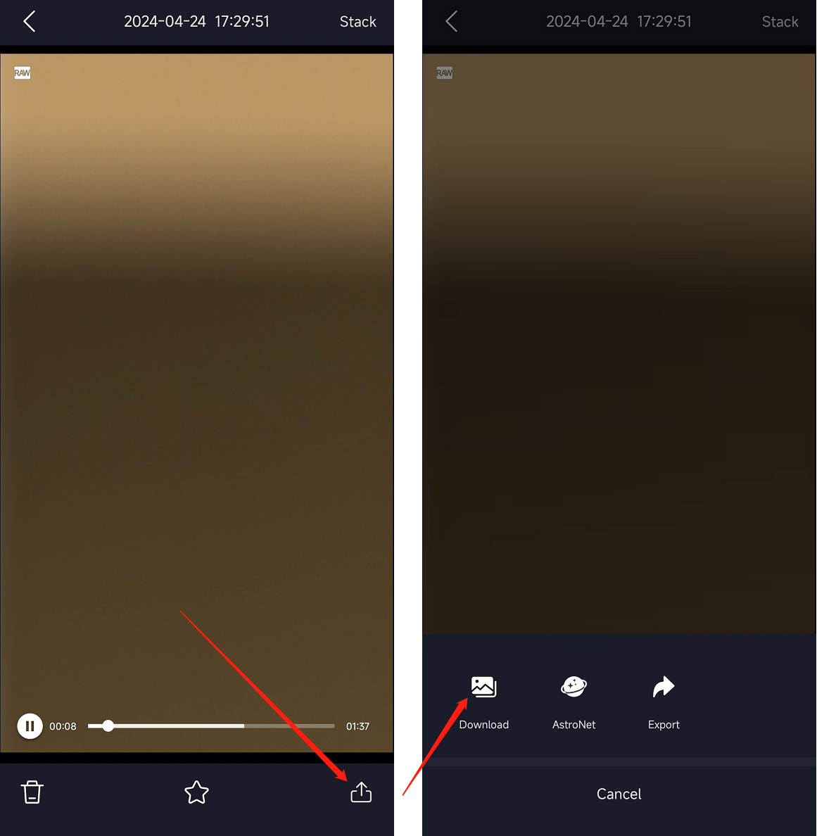

| 延时摄影(非 RAW) | MP4 | Seestar 存储 | 可直接通过 APP -Seestar相册点击下载到手机相册里,也可接电脑从 Seestar 存储中手动导出。 | |
| 延时摄影(RAW) | AVI | Seestar 存储 | 如需 AVI 格式需接电脑从 Seestar 存储中手动导出, 通过 APP -相册点击下载,会转换成 MP4 格式,下载到手机相册里。 | |
| 视频(非 RAW) | MP4 | Seestar 存储 | 可直接通过 APP -Seestar相册点击下载到手机相册里,也可接电脑从 Seestar 存储中手动导出。 | |
| 视频(RAW) | AVI | Seestar 存储 | 如需 AVI 格式需接电脑从 Seestar 存储中手动导出, 通过 APP -相册点击下载,会转换成 MP4 格式,下载到手机相册里。 | |

视频/图片下载
Q1: APP 中如何下载视频和图片到手机相册? | Q1: How to download videos and images to the phone album via the APP?
A:进入要下载的图片或视频页面,点击右下角分享图标,选择下载即可。下载完成后可直接在手机相册中查看。
A: Open the image or video you want to download, tap the share icon at the bottom right, and select Download. Once downloaded, the file can be viewed directly in the phone album.

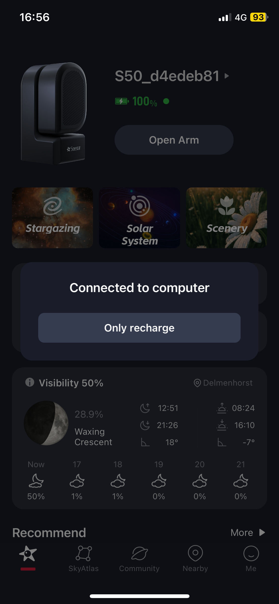

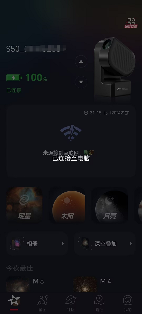

当用户将 Seestar 通过 USB 线接到电脑时,打开 APP 连接上该设备后会出现这个提示,这个状态下 APP 内无法做任何操作,移除 USB 线之后即可恢复。
Seestar 使用USB连接电脑时提示格式化的处理方法
这通常是由于系统文件损坏或电脑权限设置异常引起。您可以先尝试更换 USB 数据线重新连接设备,如果仍无法访问,可以通过 WiFi 导出 Seestar 上的图像文件进行备份(参考教程:https://h5.seestar.com/course/79216)。之后可进行格式化操作,但在电脑上格式化时请务必选择 exFAT 格式。格式化完成后,再使用 USB 数据线连接设备即可验证是否恢复正常。
How to Solve the Format Request When Using Seestar with a PC
It is usually caused by corrupted system files or abnormal computer permission settings. You can first try replacing the USB cable and reconnecting the device. If it still cannot be accessed, you can back up the image files on Seestar via WiFi (refer to the tutorial: https://h5.seestar.com/course/79218). After that, you may proceed with the formatting operation, but be sure to select the exFAT format when formatting on the computer. Once formatting is completed, reconnect the device with the USB data cable to verify whether it has returned to normal.

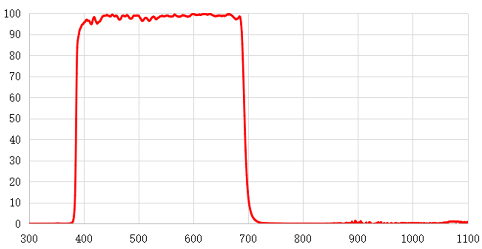

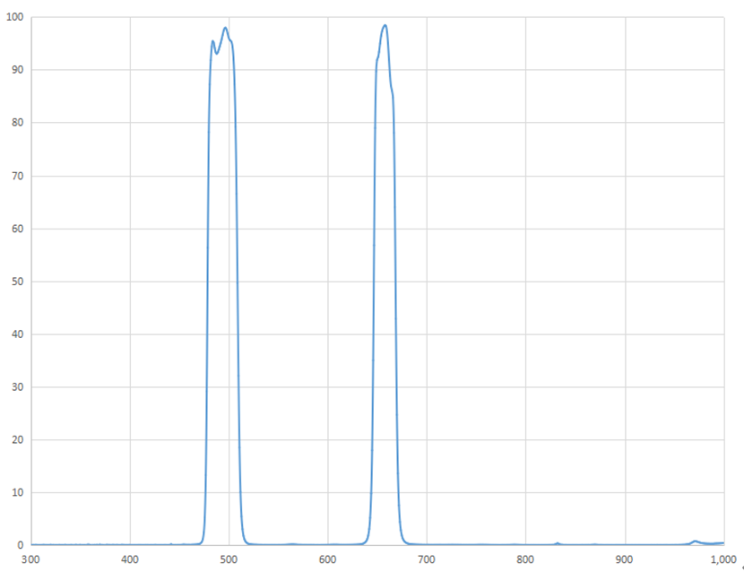

A: Seestar S30内置了三种滤镜:UV/IR Cut滤镜、暗场滤镜和双窄带光害滤镜(带宽OIII 30nm/Hα 20nm)。Seestar S30还附赠了一块磁吸式的太阳滤镜,可以用于拍摄日面。
A: The Seestar S30 comes with three built-in filters: UV/IR Cut filter, Dark Field filter, and Dual Narrowband Light Pollution filter (bandwidth OIII 30nm/Hα 20nm). The Seestar S30 also comes with a magnetic solar filter, which can be used for solar disk photography.
光害滤镜(LP filter)
红外截止滤镜(UV/IR Cut filter)

Q3: Seestar S30在低温环境下充不进电怎么办? | Q3: What should I do if the Seestar S30 cannot be charged in a low-temperature environment?
A: Seestar S30在低温环境下充不进电的解决方案如下:
A: The solution to the problem that Seestar S30 cannot charge in low-temperature environments is as follows:
- 低温下充不进电,但能供电工作是正常现象
- It is normal that the battery cannot be charged at low temperatures but can still supply power for operation
- 请在温度高于0℃的环境下进行充电
- Please charge in an environment with a temperature above 0°C

Seestar S50 内置了三种滤镜:UV/IR Cut 滤镜、暗场滤镜和双窄带光害滤镜(带宽 OIII 30nm/Hα 20nm)。暗场滤镜会自适应来切换。用户可以在 Seestar app 内切换 UV/IR Cut 和双窄带光害滤镜。
Seestar S50 is equipped with three built-in filters: UV/IR Cut filter, dark filter, and dual-band anti-light pollution filter (OIII 30nm/Hα 20nm). The switching of the dark filter is automatically controlled by Seestar. As for the UV/IR Cut filter and light pollution filter, users can switch between them in the app based on their own needs.
UV/IR Cut 滤镜:将紫外线和红外线采用一刀切的方式过滤掉,只让可见光波段通过。光谱曲线图如下:
UV/IR Cut filter: Filters out ultraviolet and infrared rays and only allows visible light to pass through. The spectral curve is as follows:

双窄带光害滤镜(带宽 OIII 30nm/Hα 20nm):有效降低城市光污染及月光所带来的影响,特别适合发射星云的拍摄,光谱曲线图如下:
Dual band anti-light pollution filter (OIII 30nm/Hα 20nm): Effectively reduce the impact of light pollution and moonlight, especially suitable for emission nebula imaging. The spectral curve is as follows:

Q7: Seestar S50无法充电怎么办? | Q7: What should I do if the Seestar S50 cannot be charged?
A: 请尝试以下步骤来帮助解决问题:
A: Please try the following steps to help resolve the issue:
1. 按住电源键约30秒以完全关闭设备,然后重新启动并检查是否可以开始充电
2. Press and hold the power button for about 30 seconds to completely turn off the device, then restart it and check if charging can start
3. 更换电源适配器和充电线:如果仍然无法充电,请尝试使用不同的电源适配器和充电线(确保适配器符合推荐的功率要求),然后再次测试
4. Replace the power adapter and charging cable: If charging still fails, try using a different power adapter and charging cable (ensure the adapter meets the recommended power requirements), then test again
5. 重新连接电池线:如果问题仍然存在,请按照官方教程步骤断开并重新连接内置电池线,然后启动设备并检查充电状态
6. Reconnect the battery cable: If the problem persists, please follow the official tutorial steps to disconnect and reconnect the built-in battery cable, then start the device and check the charging status
7. 检查充电端口:如果以上步骤均无效,建议仔细检查充电端口,查看是否有碎屑、灰尘或可见的损坏,这些都可能导致接触不良
8. Check the charging port: If the above steps are ineffective, it is recommended to carefully inspect the charging port for debris, dust, or visible damage, which may cause poor contact
9. 如果完成以上步骤后问题仍然无法解决,请联系技术支持
10. If the problem persists after completing the above steps, please contact technical support

Q18: Seestar S50 Pro内置了哪些滤镜,各自有什么作用? | Q18: What built-in filters does Seestar S50 Pro have and what are their functions?
A: S50 Pro内置三种滤镜:① UV/IR-Cut滤镜(紫外/红外截止滤镜)——日常拍摄默认使用,过滤紫外和红外光线保证成像色彩准确;② 双窄带光害滤镜(OIII 30nm / Hα 20nm)——在光害较重的环境下手动切换使用,可有效过滤光污染,提升深空天体成像质量;③ 暗场滤镜(Dark Filter)——用于拍摄暗场校准帧,消除热噪和暗电流。此外还配备磁吸式外置太阳滤镜用于太阳观测。
A: The S50 Pro has three built-in filters: ① UV/IR-Cut Filter — default for everyday shooting, blocking UV and IR light for accurate color; ② Dual-Band Anti-Light Pollution Filter (OIII 30nm / Hα 20nm) — manually enabled in light-polluted areas to improve deep-sky imaging; ③ Dark Filter — for capturing dark calibration frames to eliminate thermal noise and dark current. A magnetic external solar filter is also included for solar observation.
